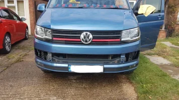

Prepping the front for an update.
Is it advisable / legal to drive round with the grille off for a week or two whilst it gets painted?
Have acquired a spare main grille but was planning to just leave the lower ones off for a bit.
I wouldn’t. Not from a legality perspective but because of potential damage to the van. You are leaving it very exposed to stones and water.

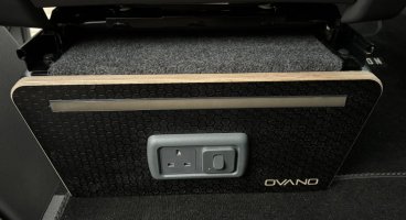

I realise that now having been out there in the dark. To be fair with my 6 Roof lights it’s bright which ever way you look. I need more light in the foot wells now, watch this space…
I decided that rather than using a dimmer, I would use some tint over the covers which would not only dim down the lights (I’ve just checked and it’s must better now) it would help blend the lights into the Ovano board as I was never keen on how much they stuck out.
Really happy with the results (the colour of the CBE is much darker in real life as is the tint).
