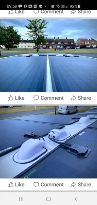

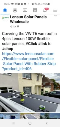

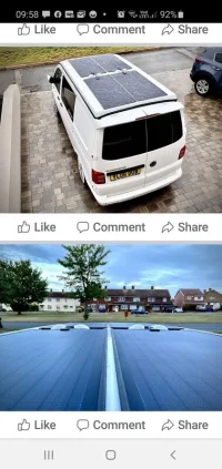

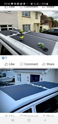

The dude with the four panels lives near me I see that van all the time.
He has a YouTube channel GDUB TV that has some interesting stuff on from time to time.
Lensun obviously bombed him with free panels

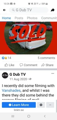

You sure thats GDUB TV.... ?
He sold his retro painted T5, and bought a white T6...... but I didn't see anything about fitting solar yet?.... or have I missed it?
Lol... oh yeh...
He's sold that T6 already..... sept2020.
I'll need to do some catching up.
