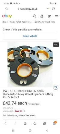

I don't think the gold part is a separate spigot ring, I think it is part of the spacer. I believe they are a combined spacer/centre bore adaptor (see pic below).
I assume you will have to remove the black spacer/gold spigot and fit a correct spigot ring for your wheels and shorter bolts.

If you look on the image the spacers are black. These are to be removed. If I remove the gold hub spacers and then put the wheel back on the hole in the middle of the wheel is larger than where the gold hub centralising spacer is. Will this affect the wheel as the bolts will hold it in place?
You should not use the wheel like this. You will need to buy the correct spigot ring. They are not expensive on eBay and such. You shouldn't use the wheels without these spigot rings
Hi @j4ckal the hub spacer comes off on its own.
Maybe so but it looks they (the black spacer and gold spigot ring) are designed to be used together.
I'd get rid of the spacers and gold spigot ring (i assume if it is separate to the spacer it will have extra depth built into it for the spacer thickness?).
Buy some normal spigot rings to adapt from the T6 65.1cb to your wolfrace wheels and get shorter bolts to suit.
