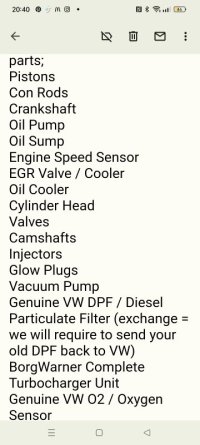

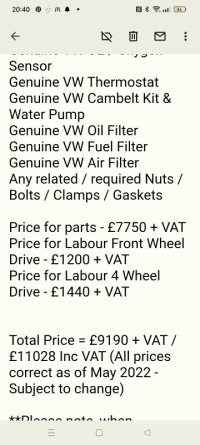

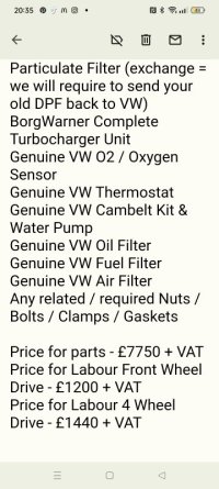

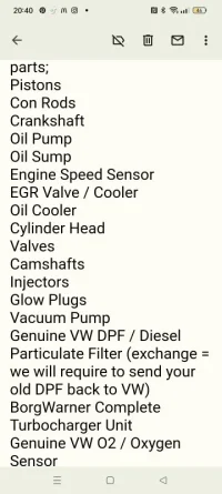

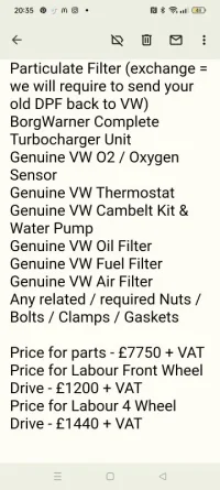

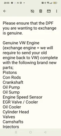

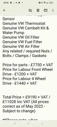

Thank you for that Venables. So the revised pierburg egr cooler that I bought from from Darksiide developments at Barnsley for £700 is worthless. There the ones that did the conpression test and said the engine was beyond repair and quoted me £11000 for the engine to be taken out and rebuilt in its origanal block with genuine VW parts and spec.

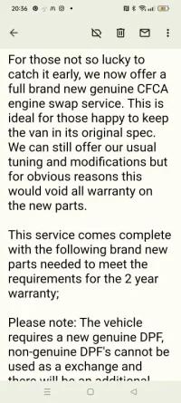

I have no affiliation to them, but would highly recommend before shelling out any more cash, that you speak to Tom Walker (or anyone) at Retro Resus. They deal with these engines week in week out and have nothing but good reviews (I also speak from first hand experience with the same problem).
For the price you mentioned above I would expect new engine, and new turbos. A fair way to travel, was 7 hours each way for me, but completely worth it.

You need a company to do the whole job and give you a guarantee of two years just buying a short engine and re-fitting your old damaged or worn parts to that is a recipe for disaster every one involved will give a different opinion as to what has gone wrong if you have a problem and no one will take responsibility.
There is nothing wrong with rebuilding the existing engine as long as you have one place to go to if you have a problem the buck stops with them.

Yes your wright, the problem is I don't have 11k as I cashed a pension in to buy my supposedly dream van.
