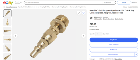

the question is. . . . what do i need to get this running off a 907 gas bottle. . . . . ?
looks like this is one option,
to go from 907 reg + QR hose,
to this QR to (1"/20 male disposable 1lb propane connector) adapter

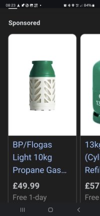

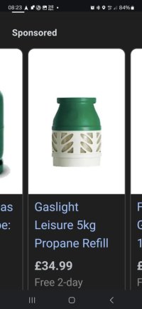

I have a few of these 5 kg 27 mm lightweight flow gas bottles. I believe it's the standard 27mm red regulator barbecue gas patio gas etc etc etc.
It's about 35 pound for a 5 kg refill yet it's only 45 / 49 for a 10 kilogram refill.
And yes I do have a 10 kg bottle as well.
So going from the above and all of this refill malarkey.
What do I need to safely refill the smaller bottle from the larger bottle so basically I can split one larger bottle into two smaller bottles which you make 25 pound refill so cheaper that's what I'm thinking anyway.
What do I need ?
And I'm thinking it might be safer to go from that company BSE instead of the eBay places.
Yep got the website but what do I need?
