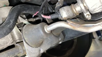

First time on the forum. I'm just on my way to VW Colindale to pick up my t6, this will be for the fifth time in 21 months since buying. Always the same issue being adblue system. From 6500m you hear the bleep on dashboard and now it says 650 m and the obligatory spanner. 3 occasions it's a electronic problem but twice (Jan 2020 and again this week ) seeming "rodents have gnawed the optical wiring", and the only option so the dealer says is "to replace the unit - that's £466.00 please".
I asked today if they couldn't surround the wiring with wirewool or place a metal cover over that area? They say not possible.
This is my first VW van after 30 years of Vauxhalls and to say the least I'm really disappointed and angry about the seeming exposure of these wires. There must be a better design plan that VW should be using to stop such a basic flaw.
So to all you t6 drivers, watch out for "the rats" or all you're get is a nice bill ever so often... what a joke!!
