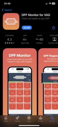

I wondered if anyone knows of an app that supports apple car play? I appreciate that this would only work with a compatible BT dongle and an iPhone, but if an app such as VAF DPF were to support car play, a simpleton like me would be sorted!
@Samro
Apple have granted me the entitlement to build a CarPlay screen for DPF Monitor for VAG. It's a work in progress at the moment, but it is coming this year.
That sounds perfect. If I just download "dpf monitor for vag" now, will the CarPlay functionality just follow later, or will this be released as a different app?
This one?
