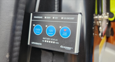

I'm surprised you didn't spec the Super Charger - I had you down for the sort of T6er that would go for a 90A recharge rate :cool:
They're lovely bits of kit but still priced very much for the commercial fleets as an alternative to a mounted generator. If the big Mastervolt Dakar ever goes in the narrowboat I'll be suggesting one of these to replace the shelf of bubbling lead acid.
Totally....
I've got a supercharger in my eBay basket for £200.
Jocking aside, id go full monty remote, bracket cable set, etc etc.
But for the screen shot above I kept it basic for anyone else looking.... Unit plus bracket.
Was chatting with skyline about these couple of weeks ago.
Awesome kit... And the looking to add expansion battery soon.
And hoping for a BT remote app and screen.
Other bug bear is the bigger unit still only has a 160Ah battery...... I'm using 230Ah Roamer and running out of power over a long weekend. (Mobile Without charging).
I suppose the reasoning is that the unit has integrated fast chargers from engine/solar/EHU. So it wouldn't take long to put charge back in as needed.

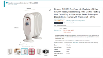

We have this one, works really well, no oil, so heats up really quick, 700w, silent, not the smallest but we make room in the colder months, also have used a electric blanket/throw, super cosyView attachment 211978
Thanks for the heads up . . .
weve now got one of these, and used it at Autumn Gathering 2023 with great effect,
great when you have EHU,
but not so great on a Britstop or two over winter, with no EHU.
so were still looking at getting a Diesel Heater at some point.

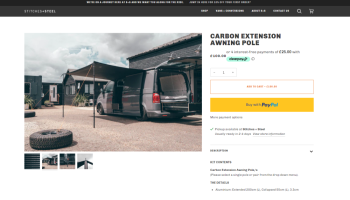

for anyone that wanted the Stitches + Steel "Carbon Extension Awning Pole" - that has been out of stock for about a year !!!
just had an email saying they are back in stock !!
limited stock, so get in quick,
just grabbed two sets (four poles in total) - Get In, =]

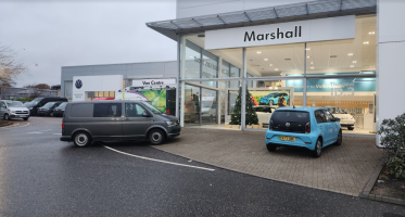

MOT Due next month . . . and being a ALL-IN customer,
VW Van center will be dealing with it.
ill update that when its done . . . 1st week of dec
The vans in the garage, fingers crossed.
lets see what they say. . . . . . . (MOT + Big Service)
plus warranty check over for "DMF-rattling" and "drivers door hinge snapped".

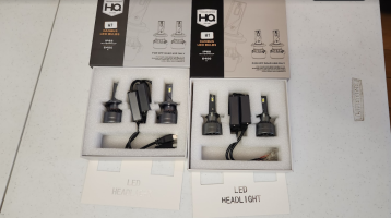

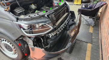

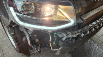

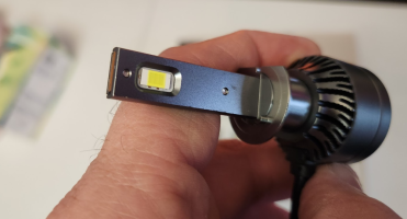

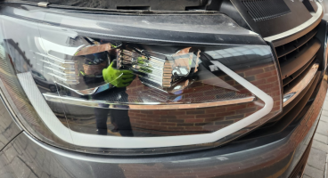

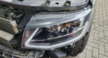

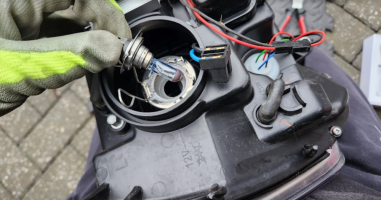

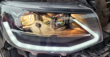

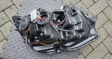

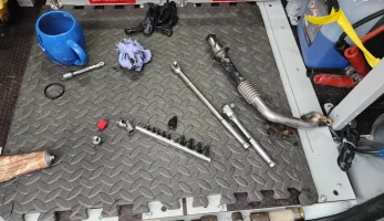

Getting the van back . . . i had a quick hour for some Black Friday upgrades.
these had arrived last week.
these THQ Leds look good, very similar to the FOG lamps i fitted on the other van . . .
there not sealed so need the rear boot to stop any moisture ingress. . . .
we have the THQ V3 fittings. . .
watched the YT vid twice. . . . . its easy they said . . . . LOL.

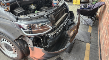

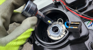

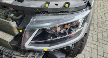

well there was no chance of me getting my porky finger in anwhere to swap these bulbs. .
so it was either starte battery and air box out. . . . or . . . . . front bumper OFF.
i chose the front bumper option.
6x torx screws each side and 4x pop clips.
then four screws on each lamp unit . . .
once they were out, it was still a bit fiddley. . .
i ended up using long nose plyers to help . . .
old out . . .
new in . . .
a quick test - then move to the other side. . . .

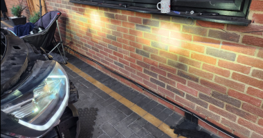

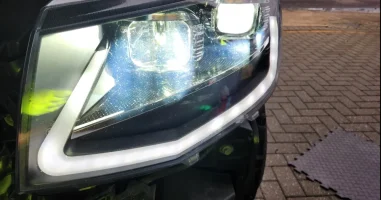

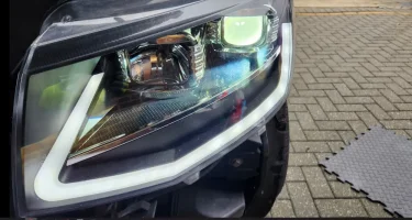

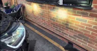

this is what we had before:
and this is what we have now. . . .
the LEDS are much WHITER in colour,
not sure how much brighter they are . . . ?
they defiantly look better.
ill have to take the van out on the track when its dark for a test. . . . ( off road us only apparently)

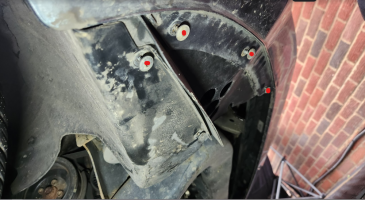

in case you was wondering how the bumper cover comes off. . . .
four pop clips - in green
2x torq screws - in red
and these 4x torx screws - in red
(4x each side)
and the light units are held in with these 4x torx screws. . . - yellow.
not too bad a job,
was done in about an hour.
happy days.
apparently there may be a "Bulb our warning" pop up on the dash with these.
if so ill do another post showing the VCDS coding to "disable the bulb check" for the front head lights.

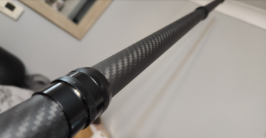

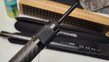

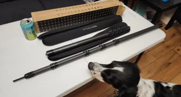

The S+S Carbon Awning Poles are in . . . . and they look awesome.
BUT . . . .
they are different !!!
they are not the same as @Deaky etc ones from before.
they have re designed them . .
they are now a 5 section carbon pole with the twist lock style pole lock. . .
the older version had the leaver tab . .
only time will tell if these will stay upright. . . . or drop with the wind etc. (that's why i liked the old ones so much - they were rock solid)
anyway - whatever . . these new ones look awesome.
they come with a sweet neoprene carry case for each one,
they have a pointed foot and,
and a screw able pole tip end.
each section is adjusted with a twist.
they are super lightweight and small to store.
check em out . . .
1702052716380.png1702052734702.png1702052743961.png1702052751238.png1702052761301.png1702052726020.png
i cant wait to try them on the next T6Forum camp out
Disclaimer : Can of BrewDog for size reference, not for my personal enjoyment.

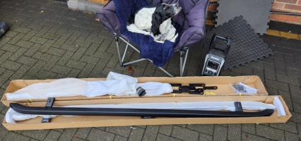

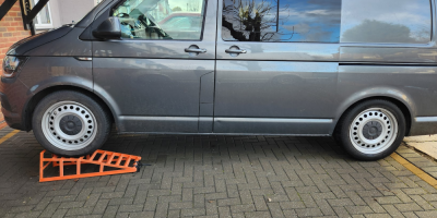

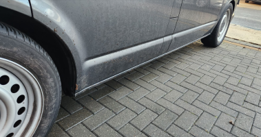

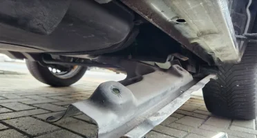

Another quick hour job - that worked out to be agro.
THQ Black side rails. . .
The van started like this . . . with no rails.
i was doing this on the drive, so ramps at the front.
this was the kit . . .l

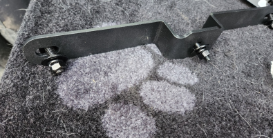

some basic brackets and nuts and bolts. . . there seemed to be two long brackets and two shorter brackets.
and some plastic paint protectors. . . which i tapped on to stop them failling off.
taking the under body covers off. . . . you can find the bungs in the chassis rails.
it looked like these cam style tabs pop into the hols, then rotate and lock in place when you tighten the bolts up. . .
and the plastic tabs protect the paint work. .
looks simple right?
well at this point it all went to wrong.. . . . with loads of agro, and more more pics taken at this point.
things i learned, that may help others:
the side bars are handed, so there is a left and right side, (longer section to the front, and trap`zd angle points down)
the brackets are 2*short and 2*long,
the long brackets seemed to be the front of the van
the short brackets seemed to be the rear of the van,
what i didn't realise at the time, is the the brackets have a very slight difference in the arm length, and can be fitted either way.

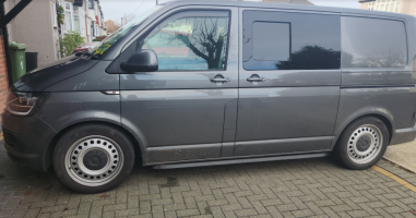

View attachment 222299View attachment 222300
looks simple right?
so either bracket can be fitted front or rear, and that each can then be fitted in each orientation.
GRRR . . . . .
after loads of shouting and cursing, . . . i had one bar fitted.
it looked to far back. . . but i measure the factory OEM rails on my other van, and they were 10cm back from the front arch.
so left it as that for now.
TBC . . . . . .

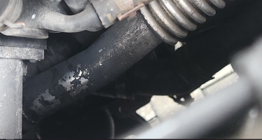

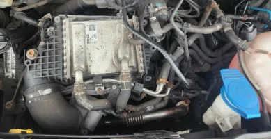

FRONT EGR Pipe
Recently i had VW Assist out to sort out a knock in the Van, - @Dellmassive`s T6 T32 Sportline 204 LWB DSG PV MY18 - Van Adventure
while the chap was there is asked him to have a quick eyeball at the bus.
he agreed that the front EGR pipe was leaking and he could deal with it . .
a week later he was back with the new part.
so sitting back with a coffee having a chat we had the part swapped.
my one was all black and sooty. . .
but , when he got it off, you could see that actually the pipe hadn't cracked. . . . like normal.
but the gasket part had failed allowing some blow by.
he changed its anyway.
it was nice to see that the VW Assist guys use the Clayton Power system in there vans - i recognised the Remote control right away.
we asked him about the other two issues . . . . . DMF rattling and snapped door hinge, he confirmed that they are garage jobs and not suitable for street-side repairs.
some interesting things i learned while chatting . . .

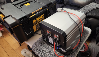

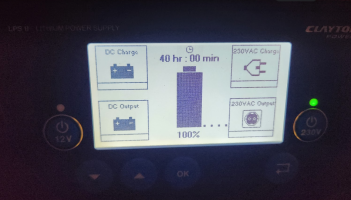

Clayton LPS - Leisure battery system . .
managed to get one of these units to play with . .
during testing we found out . . . .
the internal battery is 100ah, so might not see me through a long weekend,
you can use a buffer battery to extend the run time.
the 180A 12v output is great (verses portable setups)
the internal DC-DC charger is great.
the 2500w inverter is very capable.
