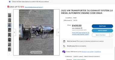

but you can see it here:
just before the rear box, a diverter valve that forces clean high pressure gas bacl to the EGR cooler. (apparently)
dont mention in that doc. .
At a high level I get what the mod is intended to do, but you could have substituted those pictures with ones of Harry Potter's Nimbus 2000 broomstick and I wouldn't any the wiser. :whistle: I was just wondering whether the mod was having the intended benefit or not.
its not a MOD you can do on a T6,
its the whole new T6.1 design of the engine, exhaust, EGR system etc. - that's what they done to improve things over the T6.

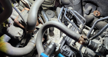

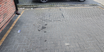

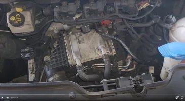

What the Absolute Hell is going on. . . . .
Noticed this, that must be coming from the BUS.
that's roughly the rear of the engine. . .
I get under and see this . . . wet gearbox at the rear.
from the topside, we can see oil around the DSG cooler area. . .
called the garage who just dont the DSG, they say they just take the box out and back in so it shouldn't be leaking, but to drop it back in for a quick loo.
well , , , , I'm not having that.
a quick call to VW CV ALL-IN and asked for a "silver van guy please" . . . . honestly these guys should be speed-dial #1.
a few hours later.
the tech seems to think its coming from the DSG cooler to box join.
those two O rings.
we checked the workshop manual and it states to clamp and break the water jacket - and leave the DSG cooler attached to the box,
but we both think the mechanic that done the Flywheel job just unbolted the cooler to make the job easier.
but never replaced the O-rings as they wouldn't have been a supplied part on the job. (as it wasn't supposed to be removed)
so that's us going to have to go back to the dealer, again, for another oil leak !!!
i now have Two transporters on the drive, that have oil leaks, related to other work that they (the dealers) have done. . . .
its doing my nut in.
obviously the Murphy's law is in full effect here.
but come- on. -- really !!!

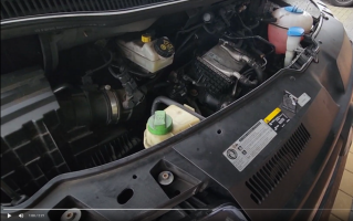

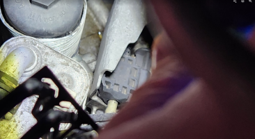

Hi Lee, I'd be interested to see/hear the vid of your rattle if you still have a copy. I have a very occasional rattle that nobody has been able to diagnose or fix. Its most prominent when cold and goes once the engine has warmed up. Be interested to hear if it sounds similar to yours. Cheers
Sure . . .
DMF rattle on the VAN before it was swapped.. . . . .
"chuck,chuck,chuck,tick tap,chuck . . . . when in Park or neutral. . . will disappear when under load/rev`s, then come back when at rest."
it starts when the engine is cold and will fade away as the engine warms.
its loudest right next to the gearbox bell housing - as thats where it lives.
you start to notice it in summer, when the windows are down and alongside other motors to bounce the sound back.
it will get worse and worse over the 5-10K untill it sounds like a bucket of bolts.
edit: oops wrong link, see here.
this is the VAN after having the DMF done - for the second time. . . .
and this is the BUS after having the DMF replaced the other week

View attachment 229898View attachment 229899
a few hours later.
those two O rings.
It went back to the garage Monday morning for an impromptu drop off and moan up. . .
"we`ll take a look at it when we can" , "we are very busy and you are not booked in" was the reply - hmm.
update:
they called to say they have "cleaned the oil off and left it on the ramp ticking over for 30mins - its not leaking, come get it, its fine, its must have been messy mechanic spilt oil when refilling?." - eh?
i asked - "its a sealed unit, have you checked the oil level? have you road tested it?"
No was the answer.
"ok we`ll check the DSG oil level."
update:
"we drained the oil - only 2.5L come out, Should be 5.5L so there has been a leak."
ok can you fill it up + new filter and test drive it please?
Update:
"we have done a DSG service (oil + filter) and will take it for a test-drive."
update:
"its still leaking oil from the cooler - we`ll replace the cooler O rings for you."
"sorry looks like we messed up and had removed the cooler from the box and pinched the O rings on refitting."
So . . . we on the fourth day now, lets see if we get it back nice and dry.
