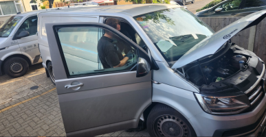

We are driving out to the Volkswagen dealership now to get dropped off and have a look at plus sorting out a higher vehicle.

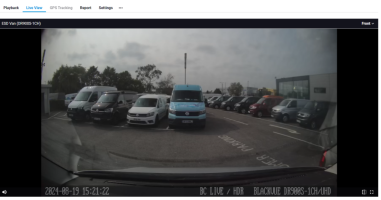

so far its still just sitting in the carpark . . .
it drove to the garage fine. . . once its was running again, it drove like normal.
just very odd.
its started on the button like normal first thing in the morning,. . . to a tick over, then stalled itself.
then wouldn't start, it was a crank no fire, but was cutting itself off mid-crank.
this was the third start attempt, that we videoed - after that i called VW Assist.
10 out of 10 for those guys, they was onsite in an hour and looked after us.
clip showing the crank no-start - stop.

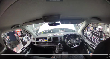

The van has CCTV with GPS , so they managed to get the van back the following day, it was dumped, emptied out and left work the doors open.
The got the CCTV from the 4 cams in the van showing what happened. But they still didn't know how they done it.

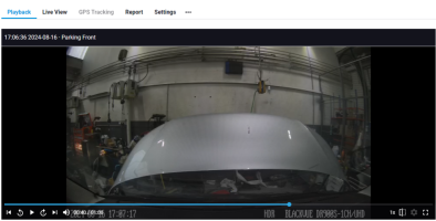

looks like the van is on the ramps after a couple days in the carpark.
lets see what they say, so far I've not spoke with anyone.
