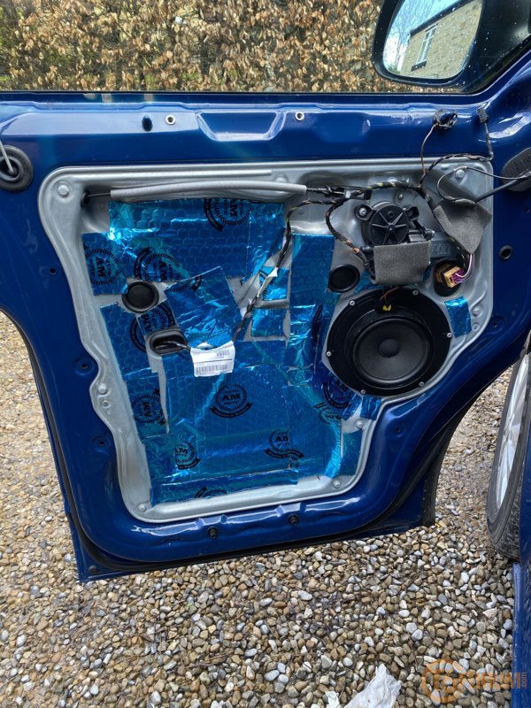

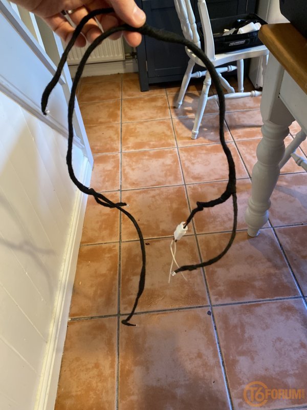

Thanks for confirming.I wired them in parallel and drilled the holes from the back![]()
