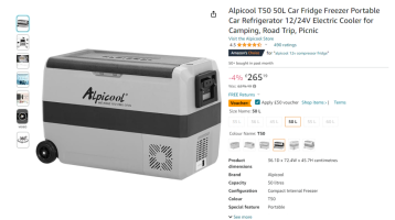

Just pushed the button on a T series Alpicool 50L Comp fridge/freezer. Only paid £215 as it has a £50 off voucher to be applied if anyones interested.Screenshot (24).png
-£50 across the range it seems. What is the difference between a cx50 and the t50? wondering if you went through them all looking at your previous posts
Bluetooth app, dual lid etc just more configuration from what i can see mate. Didnt go mad checking through all of them. T50 fitted the bill for me so thats what i plumbed for.

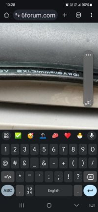

converters advise they would have used at least 20 amp cable from leisure battery to 12v socket. Attached is photo of cable from fridge to 12v socket. Fridge show voltage dropping to 10.5 when motor tries to kick in. Any suggestion would be very welcome - I would really like to get fridge running during the night. Thank you very much
See here...
6mm cable or above with 20A MAXI fuse.
That s twin 1.3mm2...
Not 6mm.
They might be using the second core for the ground.
So cable is too thin as we thought .
Volt drop over cable the battery voltage dropping over night
