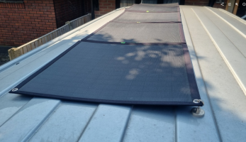

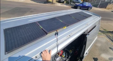

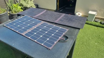

I've dropped the Fold out 200w LENSUN on the roof . . . . .

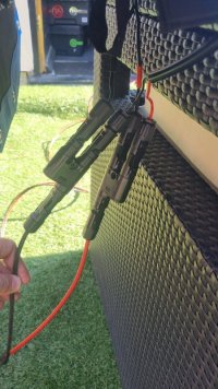

this come with a SB50 Anderson conector from the factory. . . . so i made up a short SB50 to MC4 cable.
I've added a few
MEGNET HOOKS to stop the panel from blowing away is any wind gusts . . .

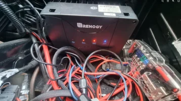

I've connevted the panel via made up MC4-MC4 cable to the RENOGY DC50s
plugged into the solar in port . . . so 25A max with an input VOC max of 25V ( my panel is 19v VOC so im good )

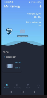

charging has kicked in . . . shown as around 7A,
thats the power going to the battery . . .
But the Renogy is showing around 8A . . . the other Amp will be feeding the WIFI and Dashcam . .
ill leave this running today and see what we get. . .
the panel is partially shaded, so I'm expecting the solar yield to increase. . .
Happy days and FREE Power (#once you have bought the gear lol)
