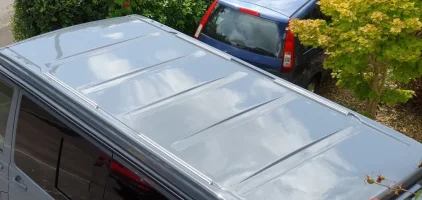

2-do your sca rails sit fully flush in sca grooves? I have ordered some from banwy vans and when I have laid them into groove front of both rails sits flush but rear of both rails sit about 3mm proud of top. Uncertain if this is correct ir if I am expected to cut rails etc etc?!

2) The rails that Hillside fitted to the SCA roof on my Birchover are shown in the images above. I’ve assumed these were supplied as a pair of rails from Banwy, but which Hillside presumably cut in half to suit the LWB version (SCA192). The cost of having Hillside fit these was £350. As I didn’t want any subsequent leaks (and potential warranty issues) I felt it was better to have Hillside install them. I was however a bit surprised that each of the rails were cut in half.

I have had a chance to explore more fully.
The rails are plumb straight.
The sca roof channel/ gutters on both sides are more shallow at rear than at front, hence kick up of rear when seen from the side.
The rails still sit flush, so uncertain once secured if this is a problem beyond aesthetics.
I will have to cut rails to minimise this overt kick up, just waiting to hear back from panel person what minimum length requires.
I will also need to work out how much clearance required at ends of rails to slide fittings into place. These banwy rails do not have centre access point like the campervan parts whole kit (but alas that is ££ and includes cross bars I don’t need).

It looks like there are some differences between the LWB (SCA192) and SWB (SCA194) versions. There’s no ‘kick up’ at the rear of the LWB version. The channel appears to be the same depth from front to rear so the rail doesn’t stick up any more at the back as the front. Also, there isn’t an opening in the rear panel of the roof canvas like it appears there is with the SWB version with the Velcro closure.

Odd that there is no centre access: I thought that was necessary in order to be able to slide the fittings in place.
The solar panel provider seems to think not a problem.
It looks like I’m going to have to shorten lengths anyhow to obviate the obvious kick up.
I am hoping that affords me the space at ends to slide fixings through.
As you say, no cut out in centre of these rails like it looks like in the camper van parts more expensive kit.
I can’t do anything about the trench being more shallow at rear. Bloody annoying tho.
I have had a lengthy convo with Solar guy whom recommends a hole into roof (outside canvas) and then fixing wire along underside of roof into rear Velcro as others seem to have done.
6FA84BF1-35FC-4212-8850-06580FC38CF1.pngUnless eyes deceiving me, looks like campervan parts rails sits higher at rear in this photo too?! So perhaps the only diff is the milled out centre section.
Prob not a big deal for me as I am only fitting panel(s)
What matters is that the rail is flat and that there is no gap anywhere along the length between it and the roof.
The strength is based upon the clamping force being evenly distributed along the length and between the fixings.
I had assumed the kick up was where it wasn't seated correctly at the end, but looks like it might just be the roof profile.
This, the bottom of rails sit flush. I think it’s just the profile issue.
