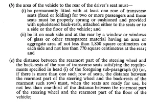

So my question regarding the above excerpt from the UKSI 1979/1092 is, in a Kombi, where the seats are removable, does this paragraph (b) (1) mean the Kombi doesn't satisfy the requirements?
No, when fitted to the van via factory fitting mount points, it's permanent.
That piece of jargon is to stop people using deck chairs, ikea beds etc as seating and claiming dual purpose status

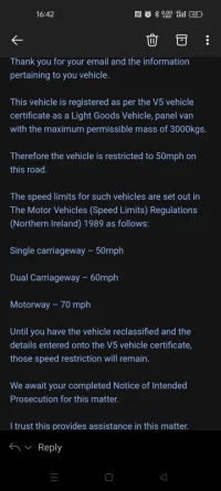

That's the one I used... Unsuccessfully made me want to go and look back at reply....I'll post it here if I can... Here it is...1000027973.jpg
