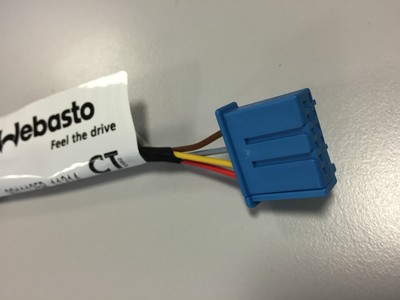

Did anyone of you got the heater running with firmware 7E0 963 272 B and a Thermo Call TC3 or TC4? VCDS Coding is 4101, but same with 4001, 5101, 5001.
When I send the start command via sms, I can hear the heater making some sound for 1-2 seconds, but then it stops :(
Do I have to use the Webasto-flash software with blue dongle to get it going with the TC3 or TC4?
Thanks in advance and sorry for my bad english.

Hi MMI,
thanks for your feedback!
Here's a picture of what's going on underneath my drivers seat :p
The wiring is as follows:
Webasto Thermo Call TC3:
- Pin 1 - +12V: Connected to +12V directly to the second battery
- Pin 2 - GND: Connected to the Ground bolt under drivers seat
- Pin 6 - W-Bus: Connected to the Green/White cable of the Red Connector
The Thermo Call receives sms messages and also sends messages back to my phone, but the heater doesn't start - only 1-2 second sound and nothing more.
Here's the VCDS Scan (sorry only in german) - It's a Gen 6 Multivan 10/2016 Model 2017:

Unfortunately I haven't done this myself. Here is what I have gathered about Thermocall TC3/TC4:
I'm afraid TC3/TC4 does not work with VW OEM heaters - thus reprogramming (flashing) of the heater would be needed for this. It seems that VW OEM heater software doesn't use (Webasto's proprietary) W-bus, instead LIN (Local Interconnect Network) bus is used and obviously between those two protocols there is some discrepancy.​
More here:​
However,
It seems that OEM heaters equipped with OEM remote controller can be adapted for TC3/TC4 by using an adapter cable (e.g. product number KW1320931A).​
However, noticed that your van doesn't have the remote controller. It would have shown in the scan like this:​
Address 18: Aux. Heat (J364) Labels:| 7E0-963-27X-18.clb
Part No SW: 7E0 963 272 B HW: 7E0 963 272 B
Component: STH-T5GP2 003 0009
Coding: 5901
Remote Control Auxiliary Heater:
Subsystem 1 - Part No SW: 3Q0 963 513 HW: 3Q0 963 513
Component: R64 D208L 004 0402
Thanks for all the information! Sounds interesting with the LIN / W-Bus and makes sense. So, if I would get the following upgrade kit, the TC3/TC4 should work without the remote controller? You are absolutely right, I don't have one installed. I also don't have the roof controller, which I want to buy.
Webasto Zuheizer - Upgrade Software mit Dongle für VW T6 (bei Aufrüstung zur Standheizung), 249,00 €
Funny thing is, that I can start the heater manually when I connect my VCDS Interface directly with the green/white wire using WTT (Webasto Thermo Test). As far as I know, WTT is also communicating using W-Bus "language". Therefore it is strange that the TC3 isn't working...!?
Thanks for the Y-Wire links. I read over in the German forum, that someone with OEM heater from VW and T91 already installed used one and connected the TC3, which didn't work. But I need to dive deeper in this topic.
Or maybe I just buy a T91 and the roof controller, sell the TC3 and keep everything OEM like ;)
I'm a little confused here, I have the overhead panel installed, but I haven't got around to fitting the Telestart unit yet. Am I right in assuming that once I have flashed the heater, the overhead unit will work? If this is the case, where can I find all the bits and bobs to flash the heater, I already have the latest VCDS, but it seems I need another interface and software!
Regards
Graham
