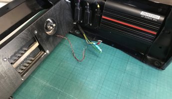

We designed the terminals to sit on a lower platform which makes cabling easier, and prevents snagging cables with a swivel seat. Ignore the chopped up seatbase :whistle:

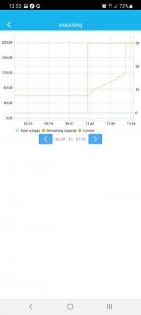

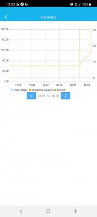

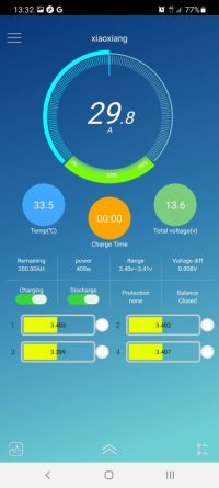

hey quick question. i just did the first charge in my garden since the battery is booked to be installed 22 sept. I charge with a victron blue smart charger 12 30 1 configured for lithium. while monitori'g the charge I saw it jumped from 120ah to 200ah (see graph) still pulling 30A though... & the victron still confirms it's in Bulk what's happening here!?
Hi Jean Louis, you need to charge and discharge the battery a couple of times before the BMS will show the correct state of charge. SoC is taken from an internal shunt so it needs to calibrate itself.
Give it a full charge using your Victron Bluesmart charger until it goes into float mode. You’ll probs get a single cell overvoltage warning from BMS when it’s at 100% which is normal, don’t worry about this.
It’ll be fine leaving it fully charged for a couple of months but if you’re able to, connect a load to take it back down to between 40% to 80% SoC before storing it.

ok thanks, . i had been told the best % to store it long term is 75% i'm pretty sure i didn't charge it completely. i stopped shortly after taking the screenshots. the interesting thing is that it was predicting reliably, 100Ah at 50%, then it reached 120 at 60%, so far so good, then 200Ah/100% instantly.
I'll leave it like this. the victon told me i must have charged about 80Ah in the battery, from 30%
Yea that’s weird that it jumped up but it’ll work itself out over a few cycles so nothing to worry about. Yep 75% is ideal so if you do charge fully then stick a 12V load on it for couple of hours to drop it down a bit before storing

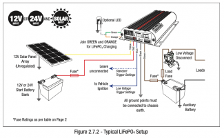

It's definitely a tight fit but with careful planning theres space to fit the Redarc DC-DC down one side, fusebox at the front and room to feed the cables down the other side of the battery. I've not finished yet, so here are some of my work-in-progress pics. I think I've made that front panel four times now! I stuck some shaped wood to the sides then bolted the charger and midi fuses to that. I recommend getting hold of an old second hand seat base and having a poke about to see what fits, then transfer everything over to your van when you're done.

Is the redarc bolted through the side wall of the seat base ?

The Redarc is bolted onto wooden boards, the boards are stuck to the side of the seat base. I did not want to drill any external holes. I have made similar wooden boards for the other side for potential future installs (shunts etc). The midi fuses are screwed into the wood as well.
