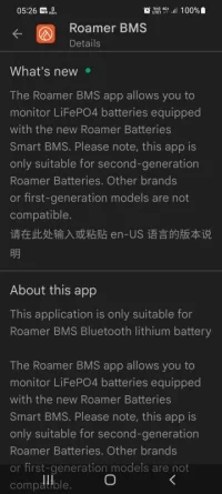

Just to follow up from Steve.
I checked this morning at 530am and see it was live.....
Play store: Roamer BMS...
Screenshot_20220204-052448_Google Play Store.jpgScreenshot_20220204-052641_Google Play Store.jpg

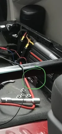

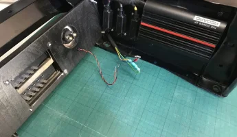

I'll be starting on my install shortly just waiting on some bits and pieces to get going. Have tigged this up today in preparation. Anyone else feel like they could just use that bit more room in their seat base ?
Got a few pics for us please?
Here are some screenshots to show how I went about securing my Roamer.
The front and back of the battery was firmly wedged into place by the seatbase and front panel I built to hold my fuses.
To strap it down I bought a couple of wide L brackets from B&Q and bolted them to the base. Then from those I can either use a strap or traditional battery clamp. I haven’t finished yet so open to alternative options and suggestions.
I’ve posted most of these before but will add them here so everything is in one thread. one day I’ll finish this project :)
