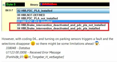

Well, on T6 the coding byte 0 as "04" definitely triggers the same fault.

I can only propose (again) to try changing byte 0 to "03".

Yes I will change it tomorrow to 03, and check what will happen
