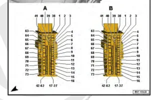

I need a little more advice please and I think someone here will know the answer to this question!
I'm a step closer to fitting the Blind Spot but before I order more parts I want to be sure I have the pins I need in my BCM.
I'm looking for B18 and B19
I can see the row 17-37 in the diagram below but where are 18 & 19 positioned in that row?
Are they next to 6 & 7 at the top, or are they next to 14 & 15 at the bottom?
