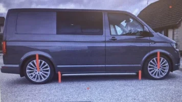

Height rake front to back, as opposed to wheel rake for alignment.
Post up your height measurements, taken as per this photo -
Check the heights as per post #34 from @Ads_Essex

If you have standard suspension and a full conversion I would suggest it’s definitely worth doing the measurements @Ads_Essex suggested.
