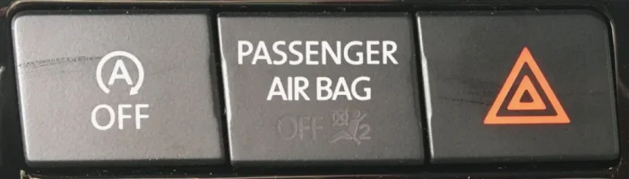

Hey @SofaKing is the passenger aibag switch next to the start / stop in your pic there if you don't like the passenger? We don't have that switch in Australia, the airbags are always active.
I have my son trained to turn off the stop start when he gets in on the way to school every morning and I have to remember the rest of the day. I can't see any fuel savings outweighing the repair costs of starter motors etc down the track. When I first got the van I counted one morning and had 43 starts in the first 1/2 hour.
e.g when having a childseat mounted face against rear.
Or, you really hate the person in the passenger side. I could swear that I have read of a case where the Husband turned it off, and then deliberately crashed the car, with the Wife in the passenger seat.
