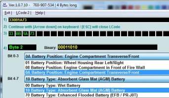

VCDS - Module 61 - (Long) Adaptations - Channel 04. Hover the mouse over data fields to get the instructions what to type in (screenshot below).
Battery Type is defined in the Codings - Byte 02:

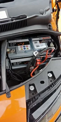

Battery in position and all the wiring reconnected, I'm just charging it up from my CTEK MXS10 charger before I program it in with VCDS.

Length353 mm
Width175 mm
Height inc. terminals190 mm
Weight26.4 KG
It's a bit of a squeeze but the battery tray is big enough and the existing bolt down bracket at the front sits in the centre indent in the battery moulding so it's not going anywhere.

In VCDS, going into 'Select Control Module' Choosing '61-Battery Regul.' then 'Coding' and using the long coding helper, I have changed the bits 4-7 in byte 2 from 70 EFB to 10 AGM.
In the 'Long Adaptation' of the same 61 module, choosing 'Battery Information/Replacement' from the drop down menu, I have changed it from 070 MLA 1111111111 to 095 VA0 7025244367 (the last 10 digits of the barcode on the battery)
All looks OK so far..
