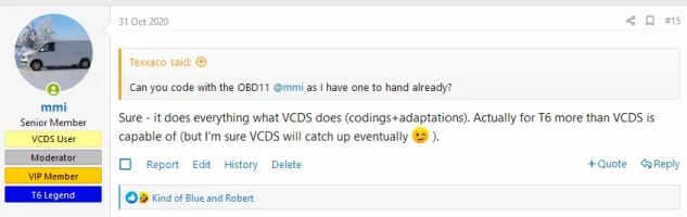

In post #7 by MMI, the drop down menu chooses between 00 (Wet), 10 (AGM), or 70 (EFB).@Grim Reaper i have changed battery and had a go at coding it- I couldn’t find how to change the 4-7 bits but did manage to change the barcode element. It was a CAN VCDS cable that I used.

Yes, of course.Anyone know if you can code a new battery with OBD11?

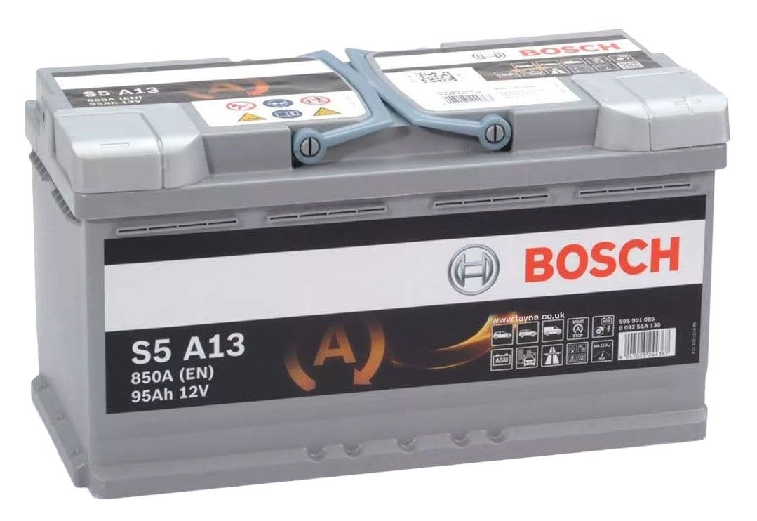

About to pull the trigger on the Bosch A13 ADM battery mentioned to replace the hopeless 2017 Moll battery fitted since new. Also thinking ODBeleven is probably worth getting to code it in.

HiThank you all for the help here. Successful install and first coding job completed![]()
That's the one!Hi
was this the battery you installed?
S5 A13 Bosch AGM Car Battery 12V 95Ah Type 019 AGM S5A13
S5 A13 Bosch Car S5 Battery - AGM (Absorbent Glass Mat) Bosch Group are one of the leading battery manufacturer companies in the world and have been delivering quality German engineering in the automotive industry for more than 100 years! Bosch is a world renown company name that have and still...www.tayna.co.uk
