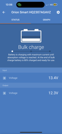

We’re back up to 12.7v on the EHU mains charger. That’s normally what I get. Disconnected the battery power feed expecting it to power off and the app shows it’s still live with 5.7 v. Presumably from the LB. I wasn’t expecting that. So I can’t reset here without getting all the connections off the LB.

Do you have a screenshot of the app in that state - which is the 5.7v against the input voltage or the output voltage?
I wouldn't expect the charger to run itself from the output but I don't have one myself, maybe @Dellmassive can clarify.
Either way 5.7v is a distinctly odd voltage to be getting in a 12v vehicle/leisure system.

When I disconnected the DC DC from the van battery I was expecting it to go dead and then reset. But the app showed it still had 5.7v so it never reset. I was guessing that the LB was somehow providing power.
Driving today the DC DC is still showing an output. Today it’s over 12v, so is it the case that below 12v output doesn’t add any charge to the LB?

The DC DC charger isn’t adding anything at all that I can see. It’s an 18A Victron smart. Maybe need to check all the cable connections now I’m back, but there’s not much to check and visually it all looks fine. Is there a way to check the output with a voltmeter? Can I just put the meter across the output connectors?

I drove 8 hours yesterday and set off with 12.5v on the LB. The Orion shows 12.1v output but there was no change in LB voltage over the whole drive. I’d have expected some increase.
I would check your wiring and fuse holders for potential poor connections and high resistance - every thing connected to the battery should be showing the same voltage, so if one is not then that's the one to look at.
Small differences of a couple of tenths of a volt are not a worry as likely just different calibration, but if you are seeing 12.1v on the Orion's connection but 14.4v presumably from your battery BMS or mains charger data - that's hard to explain.
