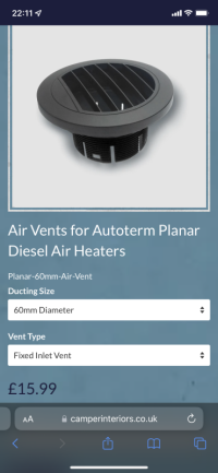

Is that vent not the angled outlet vent for the warm air into the cab? Is the other vent that you have a slimline flat one?34F728FD-A0DD-4AA7-BEA8-B3236C61825D.png
I know yours isn’t an Autoterm that was just a pic example off Google John.
