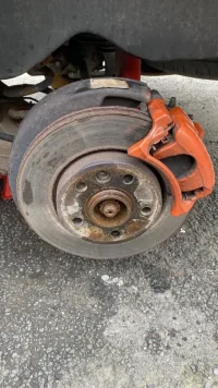

You got your money out of those pads SiJust done the disc and pads on the other rear corner. No seized and rounded bolts.
Here’s the state of the old disc.View attachment 230244

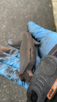

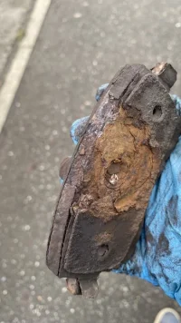

Then the shocker, as soon as I pulled the pads and saw this:-
View attachment 230245View attachment 230246
I knew my caliper was seized and the piston face pretty much toast.

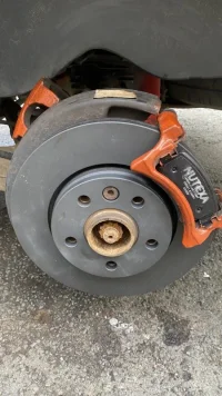

Anyway, plenty of plus gas and the piston wound back in easy and I cleaned the face up and we are now left with this.View attachment 230247
Brake cleaner has left a funny hue on the disc.
All I need to do now is try to get a garage who can fit me a new caliper before I head off to Spain on Saturday.
