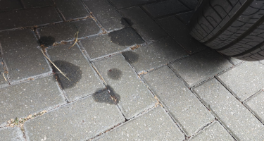

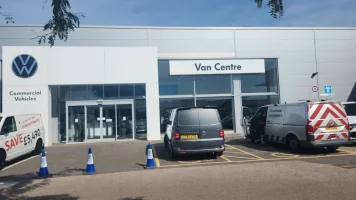

DSG box leaking - again !!
10 out of 10 for the VW Assist guy Terry . . . called him out for the VAN, - which he was deali9ng with,
so i moved the BUS over a few feet to give him better access, then spotted these new oil spots.
i asked is he could have a quick look,
which he did, then offered to raise a new job for the second van,
and managed to get this van recovered to VW, with a loan motor from Enterprise,
great service. . . .
he thinks the oil is leaking from the DSG Mechatronic cover,
possibly due to it being knocked or dented when the DSG box was last in/out/in/out/in/out/in/out/in/out/ . . . . .
after prevuoi9sly having the DMF replaced, which them lead to a DSG oil leak from the DSG oil cooler,
we believe that they disconnected the cooler to drop the box,
where as the book says split the coolant circuit and leave the cooler on the box. .
anyway the cooler was leaking oil . - so they ended up having the van back again a couple of times to sort it.
in the end they done a DSG service as good will etc.
well - now the DSG is leaking, but from a different place.

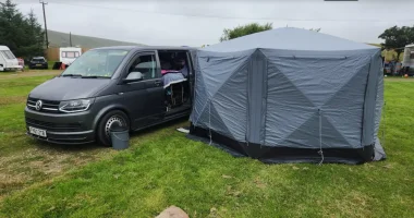

sure. . .
its the Outdoor Revolution - Screenhouse 6 DLX
(the DLX is the Pro model that me and Neil have - which includes the fitted side blinds.)
(they do a cheaper version that has no sides fitted , but can be bought as extras)
• 240HD high density all weather fabric
• Hydrostatic head 4000mm
• Quick erect fibreglass pole pop-up system
• Breathable keep cool phoenix mesh side panels
• PE mudwall to base
• Detachable guylines with quick adjusters
• Corner storm strap anchor points
• Fully zip back front doors
• Zip up privacy panels / storm covers with zip back quarter window panel
• Quarter panel PVC window to left and right
• Kador strip with 6mm piping to attach a windbreak - goes well with our Pronto Compact 3 Panel Windbreak (120 x 360)
• Velcro points to attach privacy panel wind stopper accessory
• Privacy panel rain covers to prevent leaking in
• Ground anchor webbing secure guying system
• Adjustable webbing pegging system
• Includes peg set, guy lines & carry bag
and expertly demoed here by @True Romance

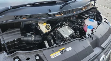

New DSG Box -- or -- a DSG glue and sticky plaster????

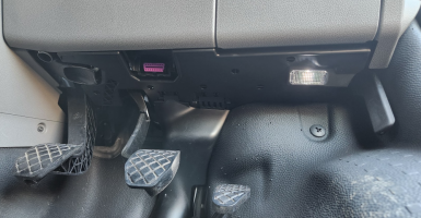

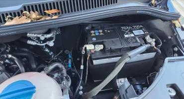

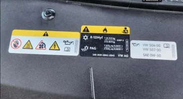

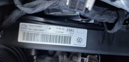

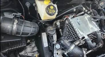

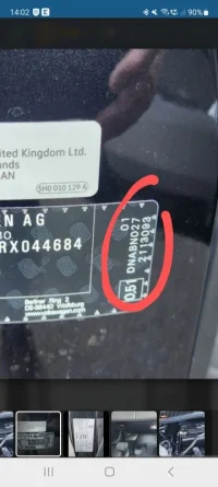

whats the deal with these T6.1s
where is the engine code?
this is a 2024 T6.1 loaner from the garage.
nice van, but no build sticker under the dash.
No engine code on the TB cover.
not much info TBH.
1729340641495.png1729340655321.png1729340665022.png1729340680852.png1729340694224.png1729340704819.png1729340715390.png1729340729556.png
apparently its been sold. .
so they want it back - :mexican wave:
  • Wow
Just plug in the VCDS :thumbsup:

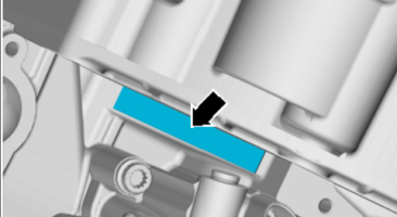

Stamped on the joint between engine and gearbox - states the workshop manual :rolleyes:
DNAA comes with 6 speed gearbox, DNAB with 5 speed gearbox 5 (as well as DNAC - 66 kW variant but probably not imported into the UK)?
EDIT: Thus DNAB
perfect. . . so i need to add these engine codes to this list. . .
as i havent get any DNA* listed yet. .
