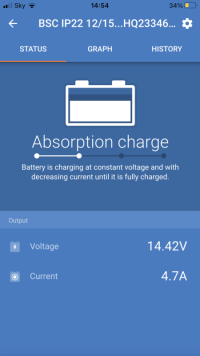

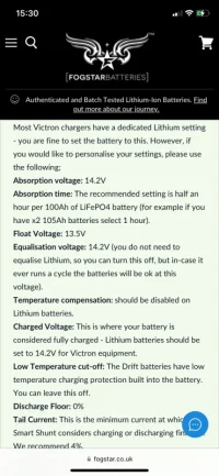

Yep. Now go into the settings and make sure it’s set to LiFePo. You can then get the charging parameters from Fogstar and adjust the bulk and float voltages to be exact.
