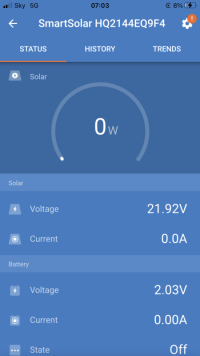

Bad news, changed Solar profile to Lifepo.
NUMBERS HAVE GONE HAYWIRE.
I have disconnected panels.
I can’t post videos but took multiple photos.
When viewing Solar in app, every second the numbers ALL change. It states BULK/ OFF/ BULK/ OFF etc and the voltages are ALL OVER THE PLACE.
I welcome all theories.

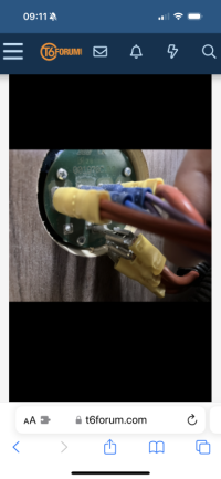

In answer to @Bigsidavies question. I followed guidance on here (you have seen my lack of skill:)), spade connectors attached piggy back from the Victron mppt onto the rear of a unit in wardrobe (unit fascia in hab area), when I did this the numbers always did show a jump around (battery did charge), I’d gone back to company who sold the panels and controller and asked if normal, could this be a controller issue? Is it my wiring??
I will try and dig out pictures from install
My theory is a bad connection somewhere. Start with this spades. I presume then that your solar cables come straight from the panel into the van then the first connection is the spade terminals?
Well those pics look like the loose connection may be between battery and mppt as the battery voltage reading is all over the place.
Get those connections checked asap as loose connections cause heat build up.
Keep the solar disconnected while checking the battery connections. You shouldn’t have solar input into the mppt with no battery connected as it can damage the mppt controller.

I followed the step by step on the install and was very happy to use spade piggy backs rather than try and route a wire all through van to leisure battery.
I will leave all disconnected until I can get some proper pictures of wiring side of install.
So where is your mppt located? In the front near the battery or in the rear?
Are the spade connectors between mppt and battery or panel and mppt?
Edit. The penny might have dropped here. So you already had wires from the rear cupboard to the leisure battery and you spliced into those using piggy back spades.
What is the CBE circular component those spade connectors are attached to? What is the routing of the cables from the MPPT to the LB?

What is the CBE circular component the spades are connected to? This:
Also the very bottom connection is not on fully so likely causing issues.

You’ve probably disconnected the wires from the rear of that cbe fuse panel while disconnecting the spades for the solar.
