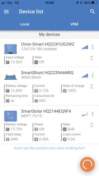

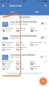

Voltages now look much better indeed.
That said, as there were some pretty wild variations and we don't know what exactly you did in between of different screenshots there's a nonzero chance that the problems return. Keep your eye on it in the near future and let's hope it all works out!

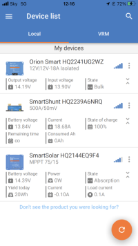

So obviously finding and fixing loose wires really important. And I THINK numbers are closer together, but when driving. Not so.
When engine off, very much so. Any ideas? Need to worry? (I recalibrated battery at 100% Soc as per Bluetooth battery info)
And I do think when the alternator kicks in for DC to DC. This superseded solar. Should that be the case? Would have thought both could feed into battery in parallel?
Should I ask the question of Victron or is the issue my install rather than settings (presume so)
DC-DC won’t over ride the solar, any output from them will combine (e.g. 18A Orion and 5A MPPT should show as 23A on the shunt (and Fogstar app) minus any load.

When the DC to dc kicks in the Solar stops (according to MPPT data on Victron screen). 18amp charging.
When I stop the engine (and thus dc to DC) the solar wattage comes online again.
