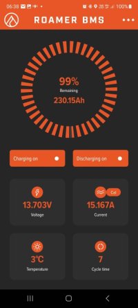

I don't see the BMS drift as a problem.... It's simply that your drawing such low loads that it can't register them... This is the same across all the Portable power packs I have and tested.
And it the same with the lithium leisure batterys that have internal BMS.
Look of the drift of my Roamer lifepo4 over this weekend.
The Roamer app shows 99% (BMS min @ 500mA)
Yet the Victron smart shunt shows 94%(BMS min @ 100mA)
That's 5% drift over 2days.
On a 240Ah battery, 10% would be 24ah, so 5% is 12Ah.
That's just how It is....
So if you manage your expectations in regards to the SOC display, and ignore it....then there shouldn't be an issue.

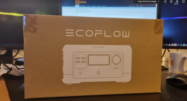

here it is , with next day delivery . . .
ECOFLOW River Mini. . .
i comes in a nice sturday box . .
the accessory pack comes with a
3pin mains lead.
XT60 to MC4 for Solar panel input (100W max)
XT60 to 12v socket for car charge input (100w max)

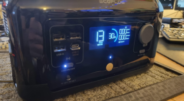

out of the box it comes 30% charged.
on the front we have the USB A/C and 12v socket ports.

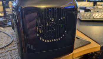

the oposite side houses the cooling fan . . .

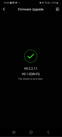

checking out the APP. . .
we see the familary EF layout . .
a quick check in the settings show an immediate FW update available. . .
which went through with no problems. . .
very nice. . . . .

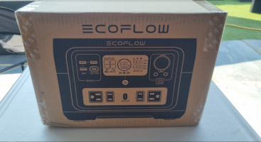

purchased direct from EcoFlow UK it arrived in two days.
i managed to use some loyalty point and got a discount,
plus used points to get the EF River 2 bag/backpack free. ( more ojn that later. )

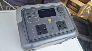

this is the unit:
nicely packaged as usual.
we get the unit, a user guide and these cables. . .
but no solar MC4 to XT60 that im a bit miffed about. . . so you will need to buy/make your own.
( i already have a couple from other EF units)
the unit is the same form factor as the baby bro that i have, just slightly larger.
i like the details sticker that shows the input specs, which is good.
so for solar we have 11-50vdc range upto 13A - nice.
the unit has rived with around 30% soc.
the screen is nice and visible in strong sunlight.

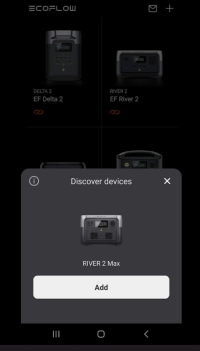

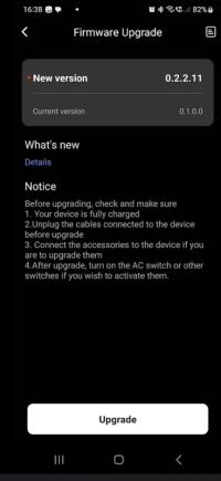

the first thing to do is add it to the APP and check for FW updates. . .
this is the EF family on the APP. . .
there were about three FW updates that self installed once selecting the update button via the AQPP.
gob done . . . .

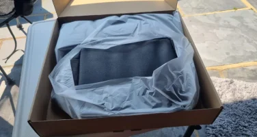

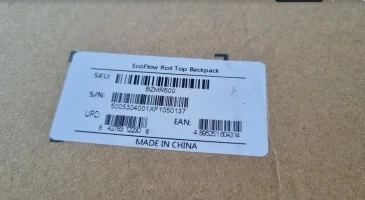

EF River 2 Bag . . .
i used some point to get thsi bag free, , , ,
it can bee seen here: (not that id pay £59 for it)
heres mine . . .
not really much to say about it. . .
ill see how it all fits in the bag later, , ,
