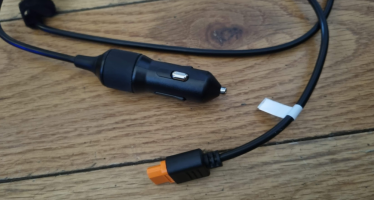

set at 8A your 12v plug will get Burnie HOT within 10min . . . leave it for 6hours and you will end up with a melted mess.
set to 6A, the plus get fairly warm, but not too hot . . . which is good, but drops the input power to say 72w ( so slower charge)
and set to 4A is even better as the 12v plug will stay cool. . . but the input power drops to 48W ( so now a very slow charge . . . . not good if your fridge is pulling 60W to start with.)

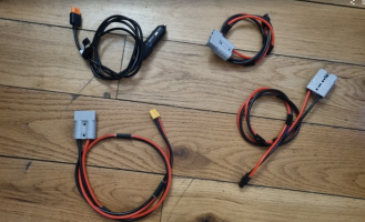

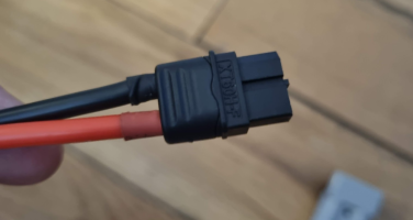

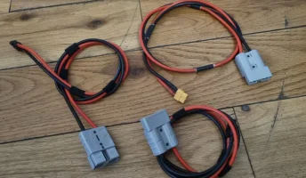

so what I've been doing is making my own cable that are better.
and today was the day when i needed to make another two.

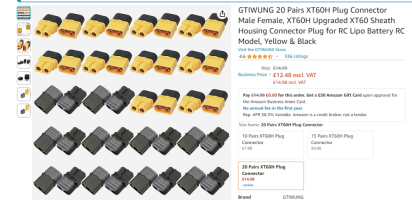

I've got some XT60 connectors, (they take a 12awg cable max) : https://amzn.to/3rqe0cO
I've got some 12awg silicone flex cable ; https://amzn.to/44O6UNP
I've got some SB50 Anderson connectores, : https://amzn.to/3OeEren
some heat shrink : https://amzn.to/3pHwMMq
some tessa tape. . . ; https://amzn.to/3rqe2kW
this is how i put them together,
i can now run the full 8A 100w charge via the XT60 connectors,
and becasue the other end is a Anderson SB50, they stay nice and cool too.
i fit 50A Fused Anderson IN/OUT connectors on all my battery boxes / storage boxes.
so its not a super easy and safe way to get full power into the boxes from a 12v supply.

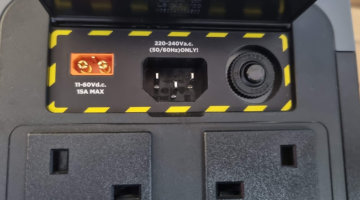

The Ecoflow and other packs normally come with a XT60 input connector, which can handle 20/30A or 200-400W,
View attachment 205748View attachment 205749
but they sell you a XT60 to 12v plug !!!.
Ecoflow have since made improvements to the boxes by allowing you to turn down the power on the 12v input.

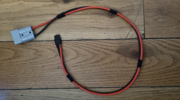

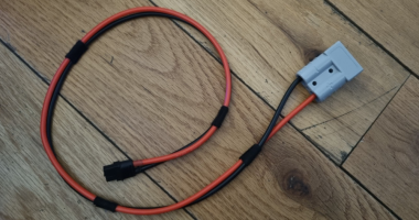

View attachment 205754View attachment 205757View attachment 205756View attachment 205758View attachment 205755

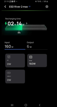

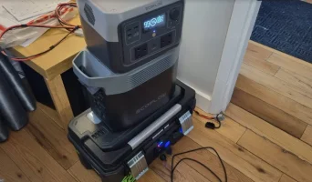

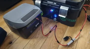

just noticed a major benefit of my cable -- 160W charge Rate from 12v --
double sweet . . .
charging and testing all the gear for T6F summer camp..
and polaying with the settings. . .

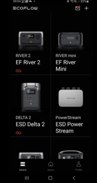

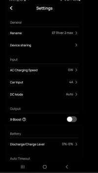

On the ECOFLOW units you can set the INPUT as car/solar/auto.
in CAR & AUTO setting ( assuming below 15v ) it sets the current limiter - 2/4/6/8A input max - so 100w
BUT
, when you set the INPUT to SOLAR it removes the Limiter . . . so woosh, max power from my battery box.
look 160W in from the 12v batteyr box.
with the EF input DC mode set to SOLAR.
this is confirmed looking at the Poweroad Lifpo4 battery BMS. . .
shows 13.0v
with the CAR setting you can see its limiting to 8A into the EF.
but with the SOLAR setting the limiter is removed and were getting 13.3A in.
which is now giving us 160W input charge power from out 12v lithium storage box.
Nice...
