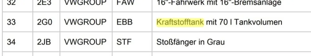

How do you know your tank is 70L? The only way I could find out for sure was to completely fill it and look at VCDS. Sure you’ve not got an 80L tank like mine?
I looked at VW's PR list that I received when I purchased it!
