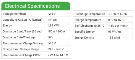

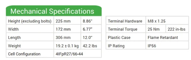

Lithium Werks provides safe, reliable and mobile energy solutions for energy storage Features
and transportation. The U27-12XP is a high-performance, 12 volt battery, built on a
patented Lithium Iron Phosphate chemistry platform providing over 1.8 kWh.
The U27-12XP is ideal for material handling, stationary energy storage, and commerical
EV or marine applications. The module’s inherent safety, long cycle life, and zero
maintenance offers end-users another alternative to other battery chemistries and
diesel powered solutions by replacing with this reliable lithium ion solution
Features
• >4000 cycles at 80% DOD
• Create systems 12 - 1000 V
• Series and/or parallel operation
• Automatic cell monitoring & balancing (edit: master BMS or software & cable reqd)
• Temperature monitoring of cells
• Rugged mechanical design
• Thread locking feature
• Footprint of Group 27 lead acid case
• Maintenance-free
No hydrogen generation or gassing
Efficient & Fast Charging
High charge effciency of >90%. Increases productivity, reduces energy costs and eliminates the need for investments in battery change out systems.

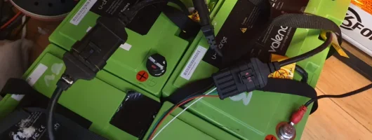

From my experience these are the IMPORTANT FACTS ABOUT LITHIUM batteries:
DO NOT OVER CHARGE THEM, (USE A CHARGER FIT FOR PURPOSE)
DO NOT RUN THEM 100% FLAT, (TRY TO RECHARGE BEFORE 10-20%)
STORE THEM AT 50% IF PUT INTO STORAGE FOR A TIME,
USE THE CORRECT CHARGER / METHOD, (LITHIUM PROFILE OR SUPPLIED CHARGER)
DO NOT SUBJECT THEM TO HIGH TEMPS (IN VAN/CAR/TENT/CAMPER ETC) (KEEP BELOW 30degC) **** MOST IMPORTANT ****
DO NOT SUBJECT THEM TO VERY LOW TEMPS/FREEZING (IN VAN/CAR/TENT/CAMPER ETC) (below 0degC)
DONT LET THEM GET WET (IE OUT IN THE RAIN) UNLESS THEY ARE IP RATED
STICK WITH A KNOWN BRAND NAMES,
REMEMBER YOU GET WHAT YOU PAY FOR, SO CHEAP UNBRANDED IMPORTS MAY HAVE SUBSTANDARD PARTS THAT MAY HAVE FAILED QUALITY CONTROL WITH OTHER MANUFACTURERS.
STAY AWAY FROM LIPO CELLS. (older lithium tech)

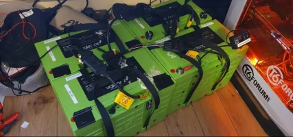

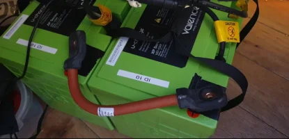

More Info for people to compare:
here my batterys data . . . . .
i currently have the 6 below
Id3
id11
id7
id 10
id 4
