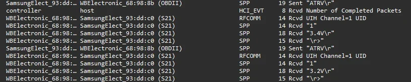

None of the codes works on my car(0x22207d & 0x22F442 ), it was strange because in the Torque App, I had the voltage.Then I sniffered the bluetooth communication apk and found the code 0xATRV , which works fine.I still have to find a way to know when the regen starts.
I see you are using serial interface (bluetooth adapter) to interface with the CAN rather than directly talking to it. That means you need to use multiple ’AT’ commands to initialize the adapter for it to be able query custom PIDs.
Not all adapters are able to do this in the first place - the adapter has to be a good quality one such as Carista or one of OBDLink ones (just as examples, there are many). For good adapters you should be able to find AT command documentation online that will detail out all the possible commands.
However, since you already know Torque and how to do bluetooth sniffing the most straightforward way would be to configure the custom PID to the Torque first and then sniff it’s bluetooth traffic to get the AT commands. Here’s a video on how to add custom PIDs to Torque:
It will be tons easier to try custom PIDs in an app than to try to get the same using AT -commands, so I would definitely start with that. Especially when it's unclear if your bluetooth adapter *and* the vehicle supports the functionality. Only flip over to use AT commands once you’re sure what you need to send and how to interpret responses.
In addition to the actual PID such as 0x22207D (regen duration / s) you will need a header 7E0 when adding the PID. 7E0 represents ECU communications as opposed to eg ABS. Finally, you will also need a formula which tells how bytes in the response will be converted back to a human readable value. For regen duration it’s just A*256+B.

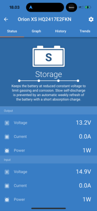

This one saved my day and aux battery. Yesterday I noticed my aux battery voltage suspiciously low - it’s usually just 14.X throughout winter:
I then switched over to Victron app to see what Orion XS thinks. It was just showing storage mode and 13.2V, obviously not right.
Today I had a chance to inspect and found the culprit:
Not sure about the quality - this came from a fuse box set I bought from local car parts store. Looks basically just like the boxes from Amazon or Aliexpress though.
Anyway, I’m just glad for once technology was actually useful :D
